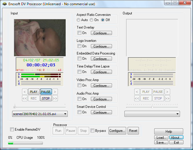

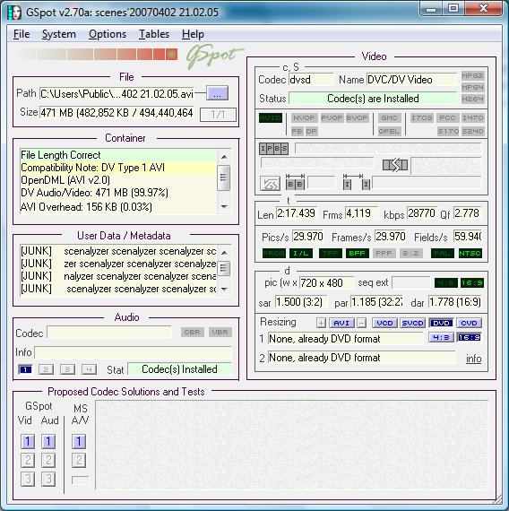

  5. Thanks for the comments everyone. Here's some more info based on your questions:
    I'll try re-capturing a bit of the widescreen footage off the camera shortly. I'll use both WMM6 and WinDV, and post the results of how WMM6 interprets the anamorphic AVI files.
    I haven't used Scenalyzer to do any capturing. I'm using the free edition, and I think it only does the post-capture scene processing.
    It turns out that you're correct about VirtualDubMod. It defaults to a PAR of 1:1, so I actually did Input Image Processing and stretched the original AVIs out to 852x480. I don't want to do that though, since it would take forever and seems to munge the ouput, even at 6Mbit+ bitrate. Of course, I'm a total n00b so it's entirely possible that I don't know what I'm doing with VDM
    Enosoft DV Processor correctly shows the AVI file aspect ratios as 16:9, as does GSPot and MediaInfo. I've attached screenshots of each.

  6. Another screenshot (can't seem to add multiple pictures to a single post).

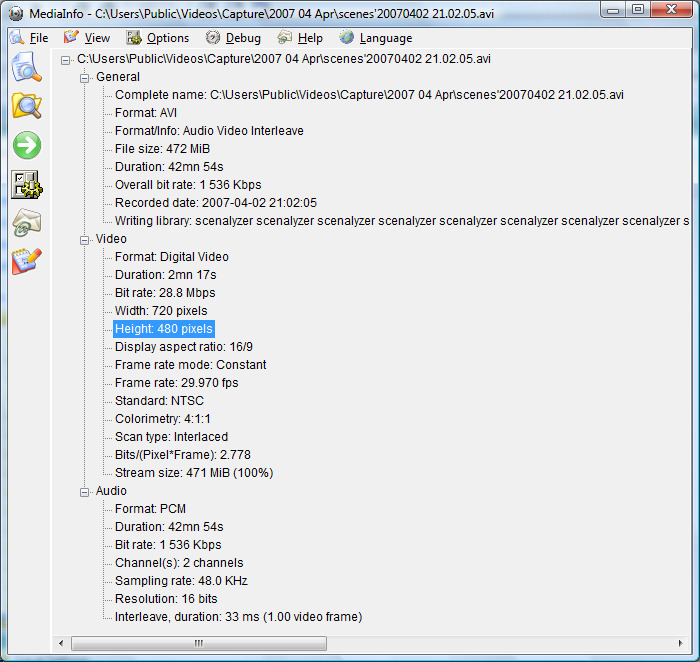

  7. And the third screenshot.
  8. Since your ultimate target is DVD, you should not change the frame size. DV and MPEG2 share 720 x 480 (for NTSC). The same dimensions are used for 4:3 and 16:9. The stretching/squishing is done by the display equipment (e.g., the television).
    John Miller

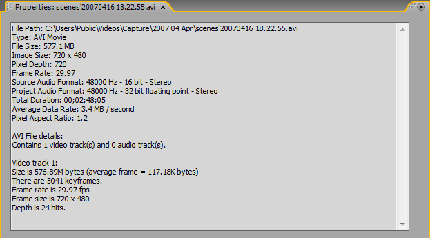

  9. It turns out that Windows Media Player isn't playing the AVIs back with the correct aspect ratio. I'm a bonehead and the sample clip I've been using looked ok, but really it wasn't. I found a better clip with a clear headshot of myself, and lo and behold, WMP stretches out my head top to bottom. So I can't use WMM6 with my files because it produces a DVD with long faces
    I also used a tool called avimaster and it reported that the AVI RIFF header doesn't contain any dimension information; height and width were both set to 0. This is consistent with the info displayed when I right-click on an AVI in Windows Explorer and look at the details - it shows blanks for height and width. So perhaps my AVIs all have crap RIFF headers, but the DV stream within is fine and it reports info that some programs notice while others don't.
    I fired up Adobe Premiere CS3 Pro and it told me that the PAR of the AVIs is 1.2. I tried exporting and changing the PAR to 1.0, and the resulting AVI playsback at the correct AR in WMP and WMM6. However, it doesn't fill the 16:9 frame in WMM6; there's black strips along all sides.
    Is it possible that the PAR in the AVIs is being reported to be 1.2, but that information isn't in the AVI RIFF header; ie it's only in the DV stream itself? Premiere has no problems playing and exporting the clips in the proper AR, but WMM6 and WMP still don't seem to notice.
    I tried AVIedit, but it locked up halfway through my sample AVI. I also tried K3CCD's AVI Repair Tool, but it requires an AVI file with a "good" header, and I doubt I have any of those lying around. I'll give it another try if I can capture some new footage with WMM6 that displays correctly.
    Attached is the file info for one of the AVIs as determined by Premiere.

  10. I just noticed that the above file info from Premiere says there's isn't an audio track. That's incorrect - the AVI files are Type 1 (as far as I can tell), and Premiere plays them back with audio just fine. Maybe that's another indication of garbage RIFF headers.
