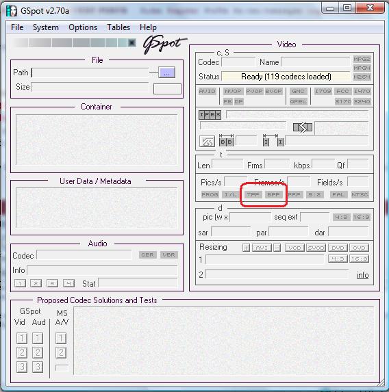

 But there may be a way to change the field order flag on your existing videos by using Restream. You could give it a try with one of your encoded MPEG files. I haven't used Restream in quite a while, but it may be able to switch the flag without doing any re-encoding. You can also drop the video into Gspot to possibly confirm what the field order really is.
 Field order indicators circled:
 Others may be able to give you better info.
	I haven't used Restream that much, but I assume you uncheck the TFF box, then process. Another way is to crop one line off the top of the video and add one to the bottom. That should reset the field order. I think Restream just resets the field order flag. Nero isn't the only encoder that does this, but I don't know why they do it anyway. My guess is that BFF is not the norm, except for DV and a few other formats, so they change it automatically.
 At least you can check it in Gspot, so if you can change it, you should be able to see the result there.

 Verified with GSpot that the Restream-processed file is indeed BFF.
