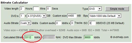

2 hours of video with no audio should fit easily on a 4.37GB DVD-5. From our VideoHelp Bitrate calculator with the audio removed.
Even with AC3 audio, the bitrate would be tolerable for most video, especially from a 8mm VHS cap.
If you needed more space, try 1/2 D1 format, still DVD compatible and will fit 2 hours easily on a DVD-5. -
