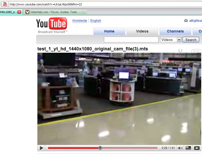

i tried a hd cam test file, converted to mp4 w/aac audio.
it's better than regular when viewed with &22 hack but still not great. at least it plays widescreen in both low and high bitrate versions.

youtube seems to be accepting just about anything for source material. i just uploaded the HD cam .mts 1440x1080 file without a problem. looks better than the mp4 sources.
