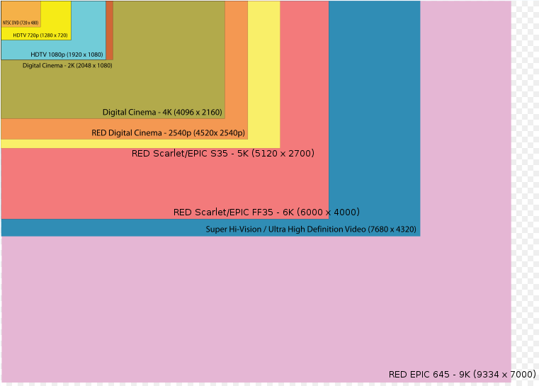

    @edDV - Where do the "red" cameras (www.red.com) stand in the hierarchy of professional cameras? or are they just "toys" at this point? Their specs on paper are amazing, at least to my amateur eyes
  13. I think most of red's catalog is there to impress venture capitalists.
    They have great potential. Recording the output economically is the problem.
    We will know when they can compare test Red vs. Film or HDCAM-SR/Viper.
    Need impartial tests.
    http://www.kiva.org/about
  17. Originally Posted by edDV
    I suspect many of the listed formats, like 28,000x9334, only exist in theory. Not even a prototype.
  18. 28,000 x 9334 isn't even listed in this graphic, it probably wouldn't fit LOL. I found this on wikipedia. There were some UHDV Monitor's demoing at a trade show in (Japan)? earlier this year.
  19. Member edDV's Avatar
    Mar 2004
    Northern California, USA
    Assume hype until test. 8Kx4k is the next step for film production. Today we have 2Kx1K or 4kx2k.
