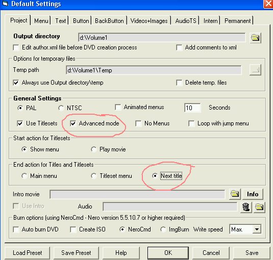

Thanks. I try to figure it out. Since I figured out how to merge the extra 7 min file on day2, day3, day4, I just have this problem on day1 because that 7 min file is slightly different (video source from vcr) and can't be easily merged with the 1hr 54min file. If I am not able to follow your directions, then I will just put a menu button for day1 part2.
Just one more question. If I want a title (video) to play through and then go to the next title (video), not stop, not repeat, but continue on to the next menu item until the end of the entire disk, how should I do this?
EDIT: I did an experiment. I added the first video (day1) and then added part2 and hid that button and then ticked "Next Title" for end action. Now when I play the DVD and click on day1, the video will play and automatically continue to part2 and play part2.
This is what I want. I still need to add files for day2, day3 and day4, but there is no part b for these videos, so I think it should work. There is no other menu other than when you insert the DVD, you should see like the above screenshot (day1, day2, day3, day4). Clicking any day should start the DVD at that point, for example, if you click day2, then day 2 video should start and the disk should continue playing until the end of the DVD. I am putting chapter points every 10 minutes, but there is no menu associated with the chapters. The chapters are just a very convenient way to use the "next" button on the DVD player to skip forward.
Ok. If that is what you want, it is exactly what 'Next title' does. No need to change any pre/post commands yourself.Clicking any day should start the DVD at that point, for example, if you click day2, then day 2 video should start and the disk should continue playing until the end of the DVD
