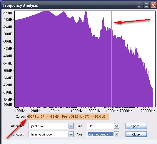

Another thing that helps to determine precisely where the "S" sounds are at is to analyze a short segment of your audio where you can hear it. In this example, the "S"es are at around 4000hz. "S" sounds are almost always above 3500hz and for a woman's voice as high as 7500hz.
