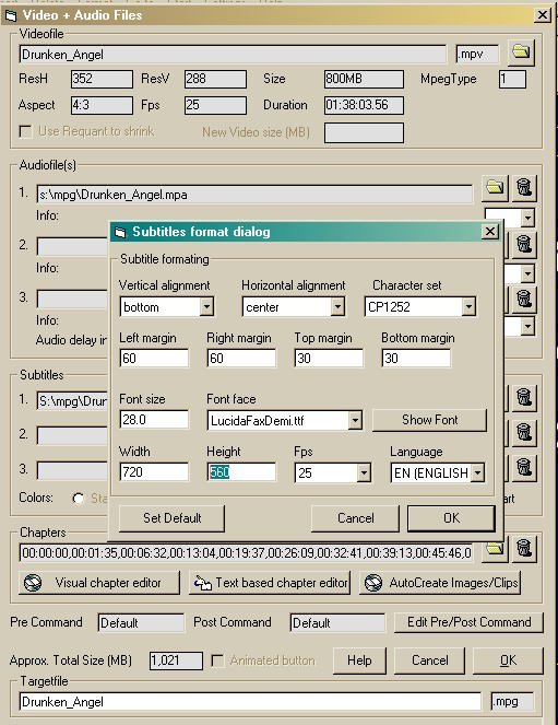

I suspect that the MPEG is MPEG1, probably originally sourced from a VCD.
Use GSPot or some other utility to tell you the specs of the MPEG.
This is valid in a DVD, but most authoring software only works properly with MPEG2.
Since I've used GfD to make DVDs from MPEG1 video (extracted from VCDs), I had exactly this problem.
GfD's visual chapter editor as you said cannot show MPEG1.
Also the positioning of the subtitles: I think that GfD was reading the frame size of the video, which is probably VCD resolution, 352x288 (for PAL). But though it positions the subtitle correctly in relation to this, actually the subtitle will be displayed as an overlay at normal 720x560 resolution. So it is positioned halfway up the screen.
You can override the default position of subtitles in the formatting dialogs in GfD. Put it in the normal position for a full-size MPEG2 DVD.
See the screenshot for how I did it.
You can also try to reposition the sub in DVDSubedit, but I found it also had problems with MPEG1, It has been updated since the last time I tried it, but I doubt it this feature has been fixed.
Hi AlanHk,
Yes, It worked...just change the height to 480 (NTSC), coz previous height was 288 & also format is mpeg1.

Hi AlanHk,
Yes, MPEG1 works fine, I've checked & I did not change in file format,
only changed the height to 480 (u cant increase in NTSC more then 480-right?), then subtitlees appears in the bottom.
