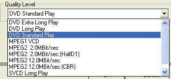

    5. QUESTION: TO make a regular DVD I selected "DVD Standard Play as the output ... does this sound right? I don't want to trust Haupps pathetic documentation.
    "DVD Standard Play" should be a good profile to start with.
