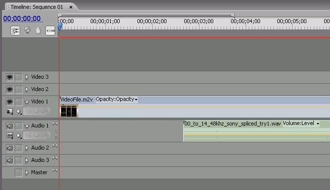

I attached an image of the initial offset to give you an idea of what I'm talking about. You'll see that at the beginning of the project there is 2.20 sec of video with no audio and I need to trim a bit more - basically need to remove the first 5 seconds of video and the related audio portion as well. And do a similar operation at the end of the project.

OK so schematically you have something like this? :
But the central portion is lined up once you have the proper delay?Code:VVVVVVVVVVV AAAAAAAAAA
Looking at the screenshot, if the audio is already in .wav format, you won't lose anything by using Premiere, because you will be re-encoding to AC3 anyway
