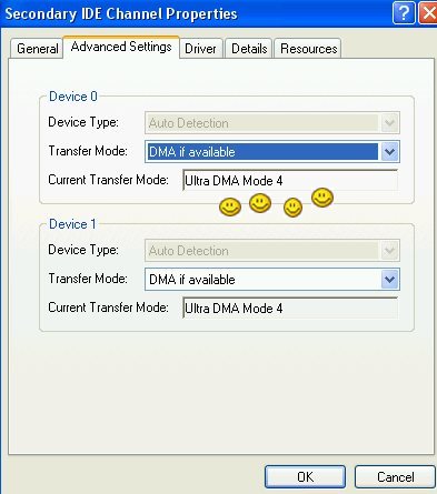

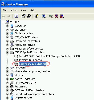

  3. Yes, I believe this happened after I tried to copy a DVD that had 10 minutes missing (and caused freezing in playback on all players). It took DVDFab Platinum about 30 minutes (unusually long) to copy the disk to the hard drive. The result still froze, so I managed to use TMPGEnc DVD Author3 to edit out the bad part and then the resulting DVD played Ok, although there was a chunk cut out. Then after this, I think that DVDFab Platinum always gave me the above warning message. But I didn't notice slower burning, so I didn't pay too much attention. I looked at the info at:
    https://forum.videohelp.com/topic355034.html
    about the problem of loss of DMA, but I like the 1 click DVDFab Platinum solution, so I clicked the "Enable DMA for DVD drive and hard drive" button. DVDFab Platinum told me to reboot and after rebooting, I checked the Secondary IDE channel and now it seems to be OK (Ultra DMA Mode 4).
    Right click My Computer>Properties>Hardware>Device Manager>click on + sign of IDE ATA/ATAPI controllers>right click Secondary IDE Channel> Properties>Advanced Settings

    Looks like it fixed the problem. You don't want PIO mode on any computer drive. It wastes a lot of CPU power and is really slow.
