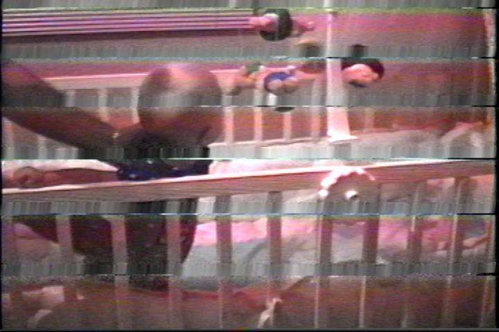

Old thread, but was relevant to me today. I had a tape where it experienced these symptoms half way through. Blue/no-video when playing, see picture when paused, or even when moving out of the menu; sound was fine. It started at a new shot/scene (home videos) so I don't know if they switched camera's or what happened.
Thought it might have been the LP issue, but checked the manual of my JVC HR-S3600U and it supports LP playback. I also tried with my Panasonic and same thing.
TLDR; I enabled video-stabilization on my HR-S3600U and was able to get a picture. It has scan lines or something on it... but at least I get some video off of it. Thought I'd leave the note of what I did and maybe that helps someone else... or might help figure out a root cause.
This is an example of the lines on the picture with auto-stabilization enabled. Disabled, I just get a blank screen with audio.
[Attachment 44520 - Click to enlarge]
