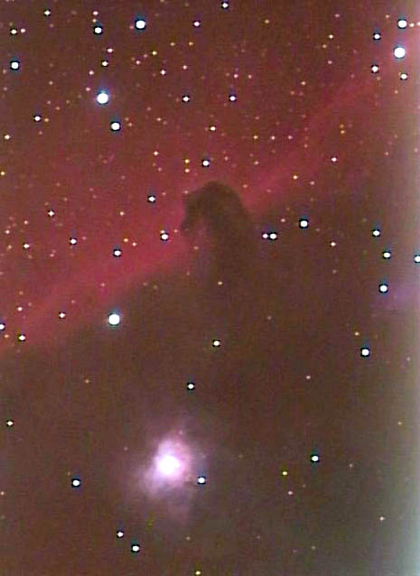

Ok, here is a sample.
Neil
Like I said, even the image that I see on the screen does not match the capture.

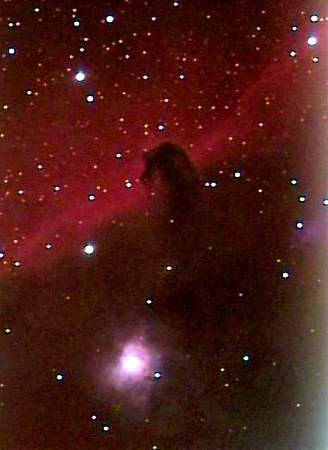

And this one realy shows the artifacts left by the TV capture devices.
Nice pictures (aside from the obvious problems)! I suspect the TV looked more like this:
but without the MPEG/JPG compression artifacts?

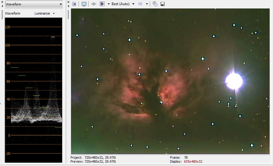

What video capture device are you using? Can it capture in uncompressed RGB or YUY2 video? Are you restricted to USB capture devices? (Probably so, if you're capturing out in the field.)
Aside from the MPEG/JPG artifacts you have a black level problem. And probably a white level problem too. A capture device with proc amp controls can probably take care of that. And capturing in uncompressed (or losslessly compressed) format rather than MPEG/JPG will get rid of the other artifacts. -

If you are capturing this 640x480 window usin the ADS VideoXpress (I have this device) you should be able to capture its window lossless without the compression though its a matter of correctly setting up the ADS and the Ulead software suite. You should be able to use the included Ulead software suite, and set it up to capture in AVI (or select the snapshop feature since you only want pictures anyway) to get the lossless pictures from your ccd camera.

I think it's normal for astronomical photographs like that to have blown out stars because of the high gain needed to make the nebulae visible. The fact that the white level is RGB 256 (rather than 235) is probably because the program that took the still frame from the video stream used the normal rec.601 contrast expansion matrix.
The high black level may be a result of the capture device's automatic gain circuitry seeing a dark image and brightening it up. Manual proc amp controls should be able to override this behavior. Or maybe it's just light pollution. He probably doesn't live on top of Mauna Kea.
The black halos around the stars is caused by over sharpening somewhere along the line.
The macroblock artifacts are caused by DCT compression. Either by the capture device (to reduce bandwidth for transfer over USB) or by JPG compression by Photoshop. -
