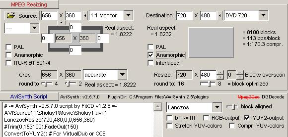

manano, I kinda understand your reply, but I'm lost on saying its 1.82 (Im new to video.) For example I really don't understand why MeGUI's input AR is set to NTSC 1.8232 or whatever it is instead of 1.778. But either way, 1.778 or 1.8232...isn't it still wrong on the dvd or bluray if the AR is supposed to be 1.85? On a note on the 1.82 thing, when I've done encodes in MeGUI with clever anamorphic using the MeGUI automatically detected input AR of NTSC 1.8232 or whatever the number is, I looked at the final encode and compared it to the original dvd and it looked like it was stretched horizontally (wider than the original dvd, or shorter up and down, however you want to describe it.) When I manually set the input AR on MeGUI to 1.778 it seems to look more close to the original dvd AR. I'm really confused about the 1.8232 thing. I too would tend to lean to trusting the studios to do it right, but at the same time I know what my eyes are seeing.
Just thought of something else....so maybe I was wrong about how off the AR is...1.85 to 1.82 is a small difference. But how about Finding Nemo for example. dvdempire.com and the box says its a 1.778 AR movie. The movie has no black bars encoded. So from your reply, I'd assume its actually 1.82 on the dvd. So 1.82 to 1.778 is a bit more off and maybe noticable by a perfectionist like me. Again I'm almost completely new to transcoding and video stuff in general, but it still seems to me something is wrong with the 1.778 and 1.85 AR DVDs and blurays. -
The same as FitCD, eh? Also the same as the Gordian Knot Resolution Tab (with ITU resizing checked). Look, I don't pretend to be an expert on this. Just be aware there's more here than meets the eye, and the real answer (if there even is one) isn't always the intuitive one.For example I really don't understand why MeGUI's input AR is set to NTSC 1.8232 or whatever it is instead of 1.778.
