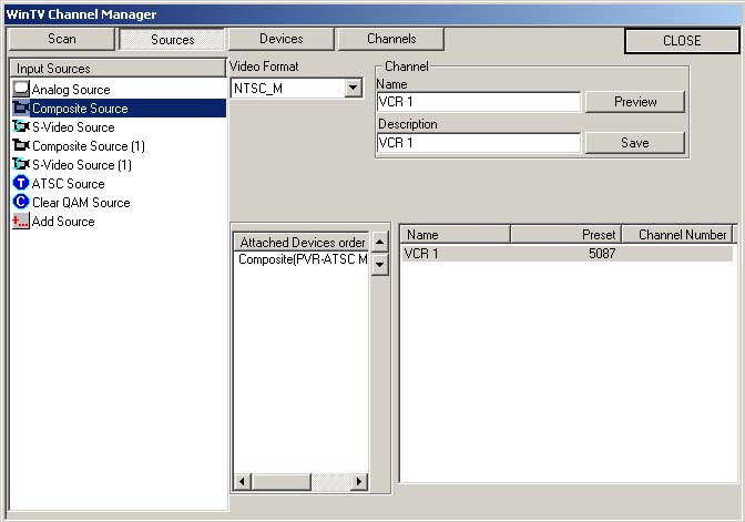

    It also allows for composite and S-Video capture.
    Have you done any experimenting with the new ATI HD-AIW? It has a daughter card that allows composite, component and S-Video inputs and outputs.

    I bought the VisionTek TV Wonder 650 Combo PCIe HDTV Tuner PVR (which is part of the AIW) back in May but it doesn't support QAM in XP so I exchanged it for the Hauppauge HVR 1800 MC Kit which was $20 cheaper plus I got a $40 rebate. I paid $60 for the Hauppauge.
    If I had Vista and would've waited a month to build my new PC, I probably would've bought the ATI HD AIW since the HD3600 is a better graphics card than the HD2600 that I bought. I only paid $140 for both the HD2600XT and the Hauppauge 1800 though. The AIW is $199.
