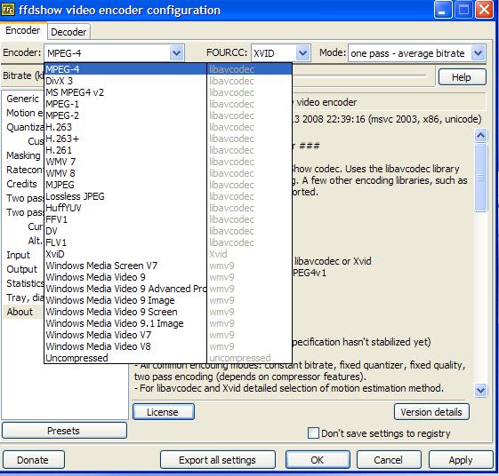

 I think my ffdshow/VFW doesn't come with H.264 encoder, right? (attachment)

 jagabo is correct, your version of ffdshow doesn't include the h264 encoder component. (don't worry, that implementation is very poor quality, and the settings are limited)
 Although the newest x264vfw is very updated with a new GUI (i.e. contains all the new developments of the x264 CLI version), you should be aware that when using x264vfw in vdub you are limited to .avi containers, which is not 100% compatible with AVC content. It works most of the time, but some players may not like it.
