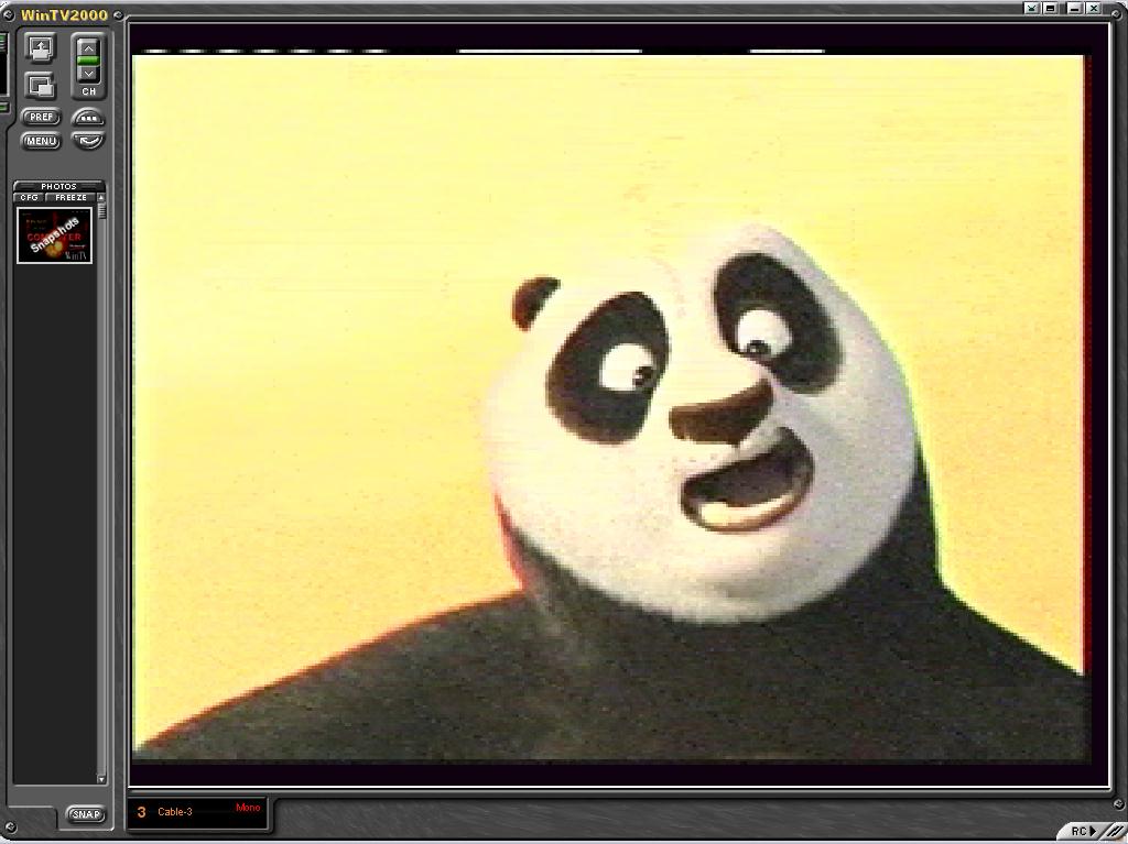

Usually when I capture video with my USB Hauppage WINTV it captures mono audio but on 2m stereo channels but sometimes it only manages to capture one channel instead making the video only to sound in one speaker or one side of the headphone respectively. What could be causing this, and how to fix it?

Well that could be hard given the fact I do not own or have a stereo TV set but when I run WINTV the sound comes perfectly from both spekars or both headphone speakers with no problem whatsoever it is only when I actually do some capturing (recording) that this problem becomes apparent which sucks because is very deceitful. I have Dish Network by the way, does Dish has the same problem as Cable?Originally Posted by jman98
