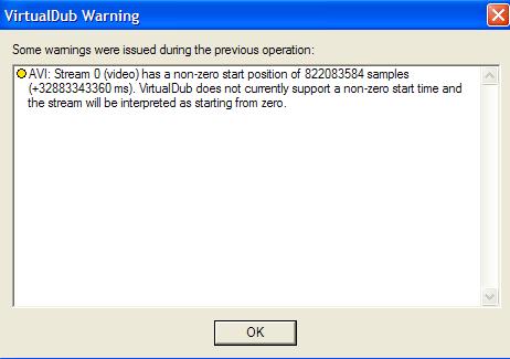

    2) I used Avidemux to join/convert/resize 3 files into a new file, MPC plays that file no problem, however my the other two players wouldn't play it and I'm getting this message (attached) from Virtualdub when trying to open the file..what did I do wrong and how to prevent this from happening again?

    That's what I did in the 1st place using Avidemux to join/append all those 3 .wmv files and I got the non zero start position thing (attachment on 1st msg).
    I reprocessed all 3 .wmv files separately into 3 .avi files the long way using VirtualDub and join them together again using VirtualDub 8) and now all 3 media players including Avidemux/VirtualDub can open that file with no errors!
