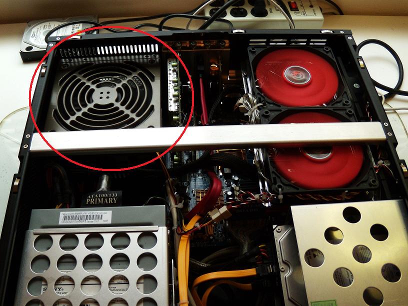

The PS in this HTPC is mounted upside down, but this is a special application:
The case was made for a front intake PS and this one intakes on the top/bottom. It's the only way it would fit.
