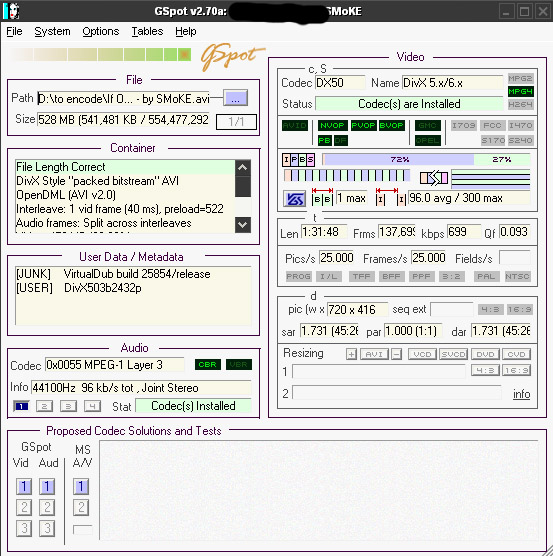

i have 720x416 25 fps source and i'd like to put it on a standard 4:3 tv

That was only part of what I asked. What do you intend to do with it? Make another AVI? Make a DVD? The answer to your question depends on knowing what you intend to accomplish. Your initial requirement:
doesn't make much sense. For example, if you have a DVD/MPEG-4 player that can play DivX AVIs, you don't have to do anything as it will already play with no problem and the player will add in the letterboxing.

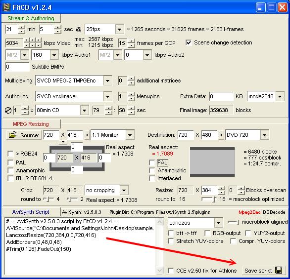

fitcd seems to work great giving me reisizing info, i just don know much i cant see a 4:30 checbox, maybe anamorphic video would do ?
nice to hear how many lines i have to add, but i just cant make it with CCSP2, is there some guide to how resize video like this, or how can i add those lines

thanks for the useful screen jagabo, i'll learn more on AviSynth, thanks for pointing me to making a better dvd
btw, all this 'trouble' someone would say, because i wanted nice encoded CCSP2 video to have 'good predictions' on the file size to try to use the most space of a dvd5 to use that size-known video in adobe encore for making not so ugly menus.
