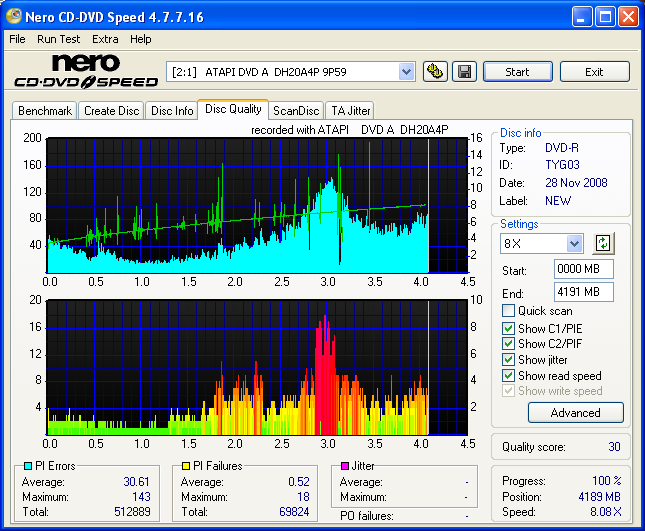

	I just bought a burner and used nero to burn them. it burned successfully. I did a disc quality test with cdspeed and got quality of 30% for one and 90% for the other. I was using taiyo at 8x. My buffer level for the one that got 30% was very low while burning. I usually get between 93-95% with cdspeed when I burned one dvd at a time. What do you think the problem is?
 http://i417.photobucket.com/albums/pp254/bauer8608/ATAPI___DVD_A__DH20A4P_9P59_28-Nove.png
 Also I watched the dvd burned at 30% and it seems to play fine which is weird.
	The problem is trying to burn too many discs at once.
 Many of those "quality tests" don't necessarily tell you anything truly meaningful anyway.
 It's just numbers for the sake of having numbers.Want my help? Ask here! (not via PM!)
	I suppose your new drive is also a IDE burner. If you want a dvd burner where the buffer levels will not fluctuate then buy a SATA dvd burner. As long as the dvd discs playback that's all that matters. Also use good quality dvd media like VERBATIM and TAIYO YUDEN.
	I've burned two disc at the same time and they both turned out ok. I'm using two Plextor, a 712 and a 716, on an Athlonxp 2000 with 512MB. The buffer on the 712 was fluctuating too, it would go down to zero then burn proof would kick in and carry on no problem. The thing I noticed is the 716 would finish before the the 712 even though both drives were burning at 4X. I think this points to the answer, both drives should be the same to avoid problems.Originally Posted by dymx
	It turns out that my liteon burner just hates tyg03 but loves tygo2- Quality rating for both were 95. I buy my media from shop4tech and they use to sell G02's but now sell G03's only. Anyone know of a cheap site that I can buy G02's from? Also, liteons seem to be very picky, I had a few tdks lying around and tested the quality rating and it was below 50% Yikes!
