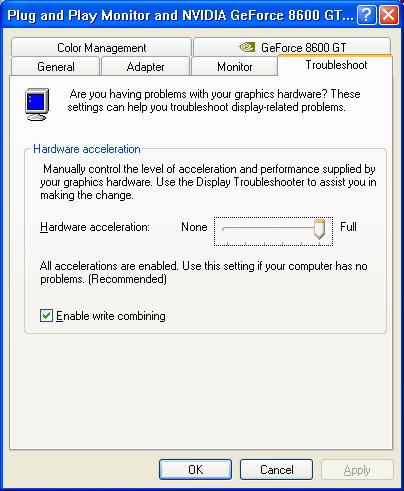

  8. From the Display Properties dialog select the Settings tab then press the Advanced button. At the next dialog select the Troubleshoot tab. Make sure Hardware acceleration is turned all the way up and Write Combining is enabled:
    You'll have to reboot for the settings to fully apply.

    Yesterday I was checking my HTPC and for some reason these settings are "greyed out" and a text saying the display driver does not support these options (when I want to click on the advanced settings under Troubleshooting).
    Strange I though and made sure that I had the latest drivers installed which I had.
    Any ideas what to do?

    I'm on vista 64 sp1 with a geforce 8800gt and my display is grayed out as well for advanced settings,just a vista issue,also the stuttering might be your cpu cant keep up with the data output of playing HDTV Live.
  12. You may have to run as administrator to change those settings.

    I have turned off the UAC so isn't a problem with administrator rights but more a vista issue as johns0 said. Also it's not a CPU issue since I can play the HD files perfectly if I am running them from the harddisk. Only experience this with live tv it seems.
