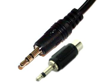

  3. Make sure you are using a stereo to dual RCA, not a mono to dual RCA, adaptor/cable. The stereo version has three or four metal sections on the pin plug. The mono version has only two.

    I like to use little stereo pin plug to RCA converters along with standard RCA-RCA cables:
    Well I ended up replacing the "stereo Y adapter" or so it was called at walmart, and it fixed the problem. The picture you posted was the only type of y adapter that I could find at three different stores and all of them only had 2 black sections on the metal plugs.

    I was referring to the metal sections, not the black band. Two black bands give you three metal sections: ground, left, and right. One black band gives you only two metal sections, ground and signal.
    Now that you have sound on both speakers you should verify you have stereo (two independent channels), not dual mono (the same sound on both sides).
