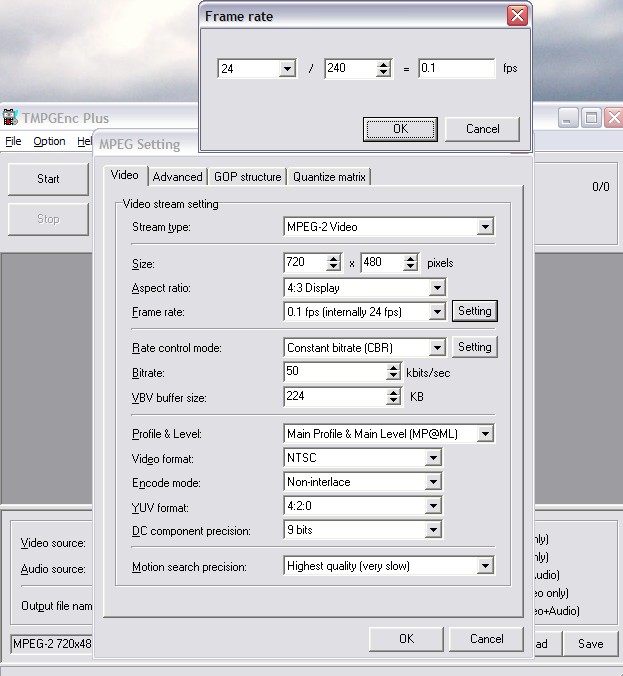

    the tool i would try is the old tmpgenc plus. here is a still i encoded at 0.1fps at a bitrate of around 50kbps using one I frame and the rest P frames.
    vincent_b_l_720x480.m2v
    right click save as
    vlc or mpc will play it

    Whoops...I forgot to mention one additional requirement. This is a deliverable to a client, so while we are free to use open source tools as part of our solution, we can't use any proprietary software. TMPGEnc Plus appears to be a proprietary closed-source tool.

  10. aBigMeanie aedipuss's Avatar
    Oct 2005
    666th portal
    dvd spec wasn't in the op's request, only that it be mpeg-2. i made mpg's with 2, 1, and then 0.1 fps in mpeg-2 format and media players all played them fine.
