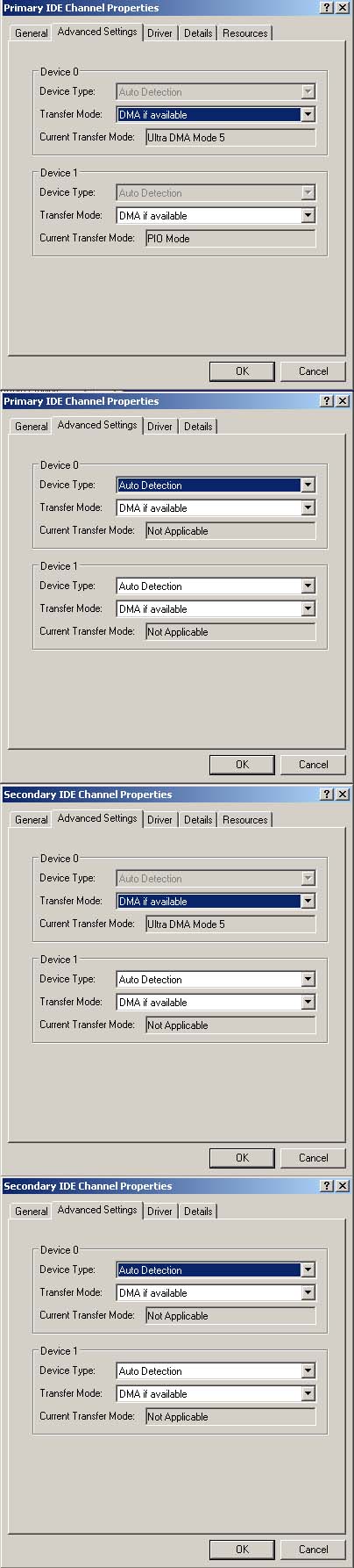

Maybe one drive is in PIO mode? A/V software? -
I turned the AV software off and it speeded things up some but nowhere near your speeds. It took 5:30 to move a 1.17GB file.
Here are screenshots of IDE Controllers in Device Manager...
I installed a program called TeraCopy that is supposed to speed up file transfers and doing a test run of a 2GB file, it says it's running at 42MB/s which sounds pretty good but when I actually go to move the file, it says it's moving it at 3.5MB/s and takes 10 minutes to move the file.
Problem solved. I couldn't figure out how to reset the Ultra DMA in device 1 on primary channel so I uninstalled the controller and let Windows reinstall it and my speeds are back to normal. I was capturing from my Hauppauge HVR 1800 the other day and when I went to turn off the TV tuner, I had an error message that a hardware failure had occurred. I guess Windows had shut down DMA mode. What was weird was that the game was over but the TV tuner was still in the first quarter. The capture was complete though.
