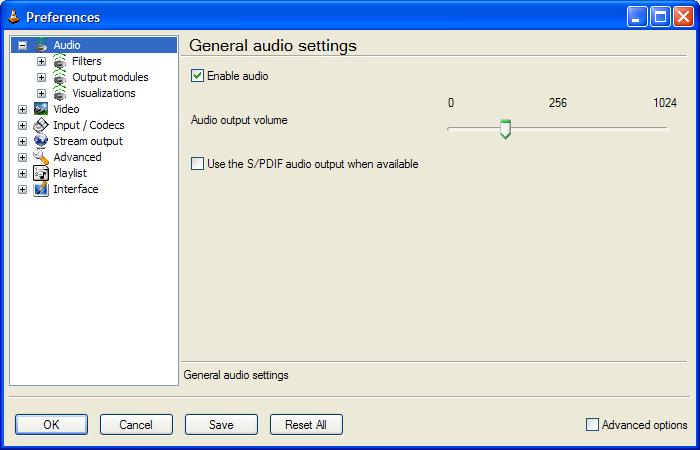

    Try media player classic as well. It might be set better. I'm sure there is a spdif option for vlc. HERE IT IS:
    Go to Settings - Preferences - Audio - and select USE SPDIF.
    Make sure that is ticked on the preference page and you should be good to go. Good luck.
