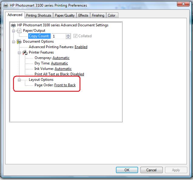

    You want them printed 'last page first', I assume? That way you don't have to reshuffle them to get them in the 1,2,3 order from the top down. Both my HP printers have that option and that's the way I usually have them set.
    I went to Control Panel>Printers>Printing Preferences (R click your printer)>Advanced' to find that.

    Or, as aedipuss suggested, you can continue using the front output tray but print the pages in the reverse order by changing the printer preferences.
