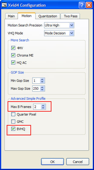

	I can only see BVHQ and GMC under the Motion tab in the Configuration settings. I will turn those off and change the Audio to 22Khz.Originally Posted by Baldrick
 I did not have a problem with the audio, the audio works fine before. I will change it to 22Khz anyway.
 The problem I was experiencing was colored blocks. Whenever a new scene would appear, the picture would refresh for a half a second and be somewhat clear, then it would quickly fill with random blocks of color.
 I could not find bvop, qpel in the configure settings.
 I was wondering if there was a video cheat sheet somewhere that tells newbies like myself what all these settings mean?
 Thank you for your reply.
	If you open your video that works in gspot, you will see that it has no b-frames. The playback issues you are experiencing is likely b-frame decoder lag
 In avidemux, turn off b-frames (set to "0") and uncheckmark BVHQ
 Here are some links to explain xvid options (they are for xvid using vdub (vfw version)), but the options are basically the same for any version of xvidI was wondering if there was a video cheat sheet somewhere that tells newbies like myself what all these settings mean?

	Thanks for the screenshot and links for info.
 Ok, I disabled B frames (set to "0") and unchecked BVHQ.
 It still didn't work.
