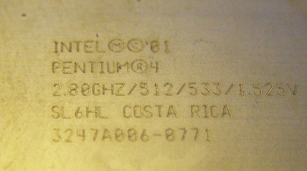

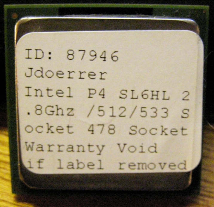

The type of Cpu you are looking for ... sounds like the ones in a HP D530C ... they are on Ebay with Pentium 4 2.8 GHZ ... no hyperthread.
Im just saying this because it gives you a starting place.
Socket 478 ... is this type of socket it uses ?? -

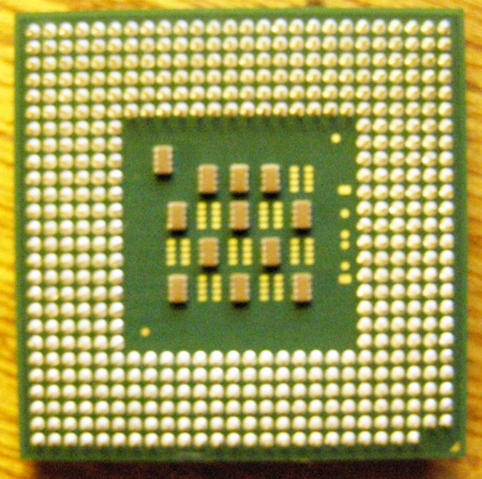

I just happen to have one of those ... I believe you are looking for ... I got a few months ago on Ebay
for a HP D530C PC
pc100032.jpg it does have pins ... even tho you cant see them ... looking straight down.
