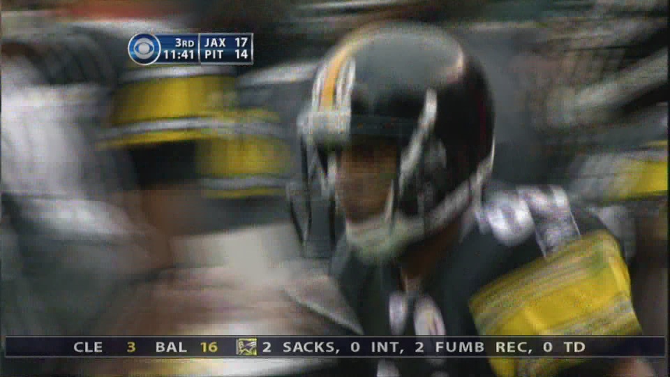

With the setup I have, I notice some lines that are shifted. So, instead if seeing this:
I've got this where I see motion ( a slight shift in lines ):

I put 1 avi and some frames here:
http://www.novifootball.org/vhelp/ -
I can't get the 48mb over dial-up, but I'm sure most others members here on DSL or Cable, can, and can assist with *that* sample for you.
As far as the pics you demos (thanks) I have to admit that they do look very good. And I was going to suggest against the ADVC-110 and go with an analog pci card instead. But, do keep it in the chain because it is doing excellent. Actually, I've never seen an home-video-made source -to- vhs tape and then captured with a dv, example. So, my theory (about the negativeness) can be laid to rest
The one great thing about the ADVC-100/110/55/etc is that they do not exhibit or induce any such line noise in the finished capture. That was one of the main reasons I gave it the title of the Holy Grail, way back when..and still deserves the title, hehe. It is just pure clean video. Anyway. I'm happy for you.
The only thing I don't like the ADVC 's are for when the source is a commercial vhs tape. The video source is transfered to tape in a completely different manor (sorry, I don't know the specifics--maybe someone else does and can explain it/the difference between analog cabletv recordings vs. commercial movies on tape) and is not in sync with picture detail/quality--looks all chisel and what-not. But in your case, it is (or seem to be) perfectly agreeable, there.
At the moment, and briefly looking at a couple of your jpeg's, I can see only one major problem, if you would call it such, (I know a few members feel it is) and that is the "halo" around the edges of certain objects. This is another part/aspect of the color errors I mentioned earlier. It is sometimes believed to be on account of one of more equipment related phenomina--aka, sharpeness setting. The greater the "sharpness" setting the more pronouced is the halo effect. And this could have been recorded to some of those tapes and nothing (if barely applicable) can remove it completely. This will undoubtly require an exerternal remedy though another tool, avisynth--and its arson of plugin filters--and would prob require a separate -editing- discussion.
Personally, I would prob leave the "halo" alone and test various encoding to mpeg scenarios. The halo is an unfortunate product of most vhs videos. But the main thing to concirn yourself with is the bitrate setup.
When it comes to vhs-to-dvd, you always want to use what leads to the highest obtainable quality possible. I always recommend CBR and min of 9000MBit/s for this configuration. But because there are many mpeg encoders, they all have their strengths and weaknesses. Take for instance, TMPGenc. It supports VBR and CBR. So, you have choices there. HCenc is another popular choice. But, it does not support CBR. It offers VBR and CQ. But, (at least in my experiments) you can "fake" a CBR by using the following--min:9000 and max:9000 and get a CBR-like encode. I was very pleased with this setup in HC..I was using v0.19 in those successfull tests. Choice/flavor varies from person to person. So, experimentation is always highly recommended.
The thing (at least with me) about bitrate and CBR and so on is that in most cases, later on down the ladder of time, and as equipment and technology progresses, ie, our viewing devices, our needs change with this. I am now seeing where people are wanting to watch their videos (home and commercial) on their newer, bigger screens. And those that encoded 352x480 (because that was what was beleived to be best for vhs) will prob suffer the most because these do not get adaquately upscaled to the HD specs of 1280/1920 since equipment designed are based around the dvd specs of 720x480, hence the upscale factor 720->1280/1920. That is my personal opinion/observation of this trend thus far. I could be wrong about the 352 vs. 720 aspects, but then again, [s:d9aacec4a6]352[/s:d9aacec4a6] vs. 720 is IMHO a greater distance to travel to get to upscaled HD specs of 1280 or 1920, from an upscale/sampling point of view. So, I would highly recommend going straight to DVD 720x480 pixels to avoid the future worries.
If you go in the direction of software encoding, then you have options..lots of them. But, be aware that with this choice comes a price--time. If you have many tapes to transfer, you have some thinking to do because time is not something that everyone has so much of. And, there is a great (or can be in most cases) a learning curve to all this software editing and encoding. Many peopel just give up and run to a dvd recorder and be done with it. I've seen a few ask zillions of quations here, and only later, turn (quietly) to a dvd recorder, and never to be seen or heard from, again. That's the way it goes around here and everywhere else.
Filteirng or noise reduction (cleanin) vhs sources can be a very tricky prospect. As I mentioned earlier, your Hi8->vhs videos seem to have come out pretty well. No tipicle "vhs" noise can be seen in those examples. So, filtering may not be necessary. I would review (below) and see how far you get in terms of satisfaction. If you think you can go further, then experiment with light filter applications. There are all kinds of filter functions. I would recommend reading up on such facts at a later time when you feel it might be necessary. Your taste will undoubtly be different than mine, and so, what you see in terms of quality or fault may be seen as something else or not at all.
My recommendations are:
1. Encode to MPEG-2 DVD 720x480 specs
2. go with CBR 9000MBits
3. image enhancements -- consider not apply filtering/noise reduction for time being
4. author to DVD
5. review in your dvd player(s) for successfull playback
and, if all goes well in step 5, then consider
6. review in a dvd player capabile with UpScale for HD (1280/1920) viewing
Well, like I said, I only took a quick glance at some of pics you posted. Sorry for the lengthy response.
-vhelp 4936 -
Thanks Vhelp.
Notice the first picture I have uploaded... see player with uniform #24? That's what I'm talking about earlier.
So... if I were to get a capture card (to do MPEG encoding), which would you recommend? Note that I'm running on Vista.
