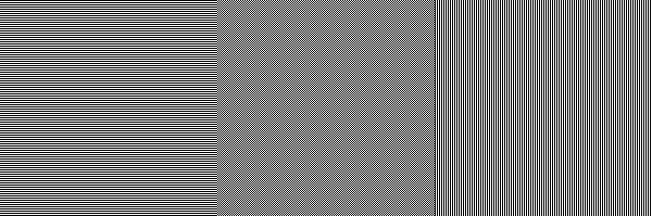

  12. You are more likely to see differences between VGA and DVI/HDMI with text or graphics than with standard definition video -- or any video that's not the resolution of your display.
    Here's one type of image that causes problems with analog cables:
    You should see alternating thin horizontal black and white lines on the left and vertical lines on the right. You may or may not be able to distinguish the checkerboard pattern in the middle. It might appear as gray. But you should not see any moire or flickering in that image if the system is set up properly.
    The quality of the analog section of monitors varies. Some models skimp on the VGA section assuming you'll be using DVI. You will see a larger difference between the two in that case.
