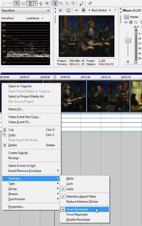

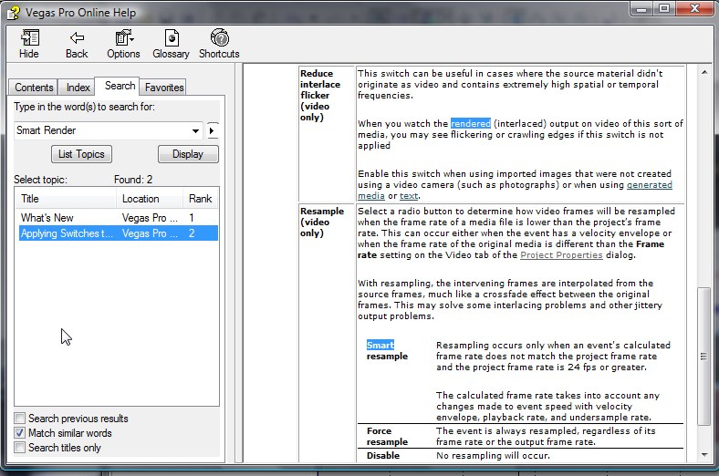

I learned that in addition to HDV, XDCAM IMX also supports smart rendering in Vegas.
and that smart rendering is specified under clip switches within an HDV or IMX project.
I've yet to play with these settings but now I'm curious.Recommends: Kiva.org - Loans that change lives.

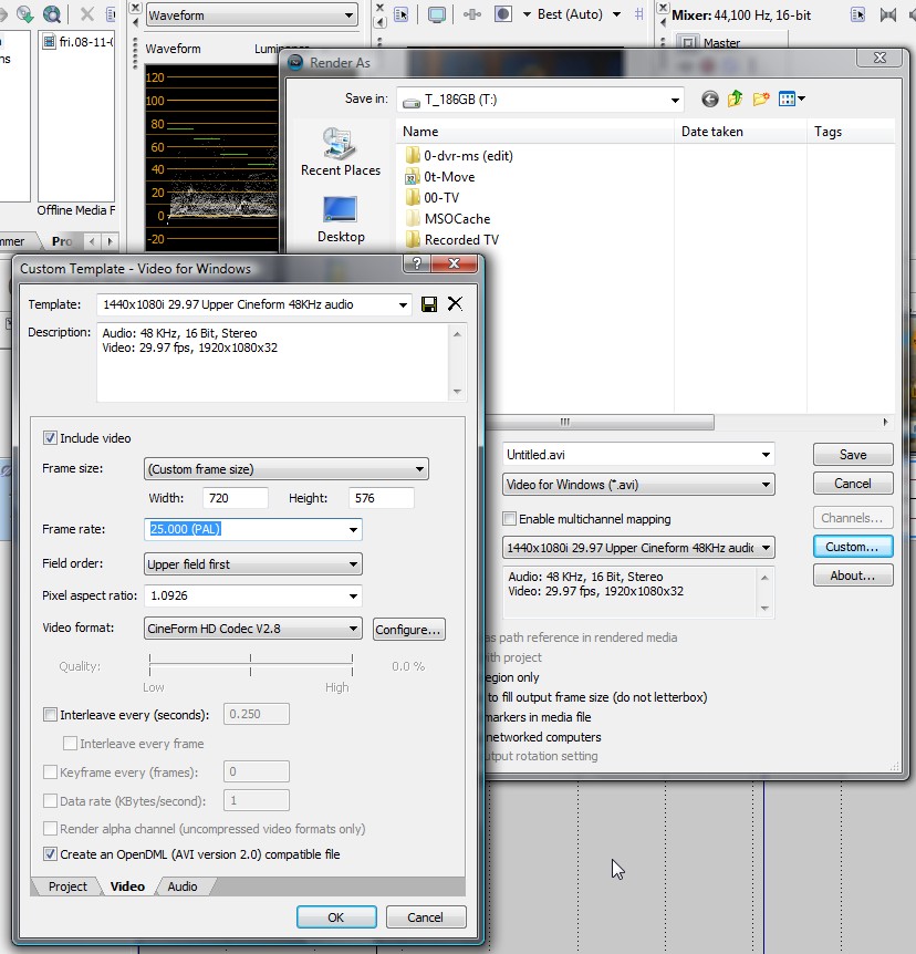

Vegas includes a Video for Windows Cineform codec that works up to 1440x1080 resolution. You find it in custom codec selections under Video for Windows AVI. I haven't attempted adapting the codec to SD PAL but this would be my first pass at a custom template.Originally Posted by Ferdinand
Alternate is convert your SD MPeg2 to DV format then edit as DV format.
