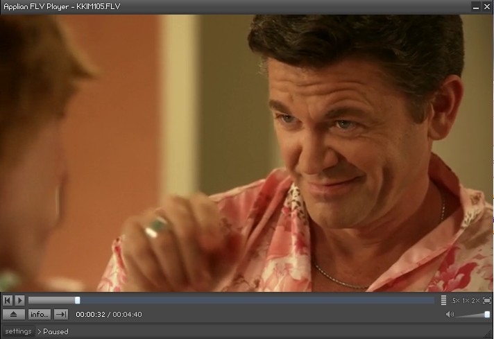

  12. i can play the 10mb sample ok, but nothing will accept it as input for rendering.
