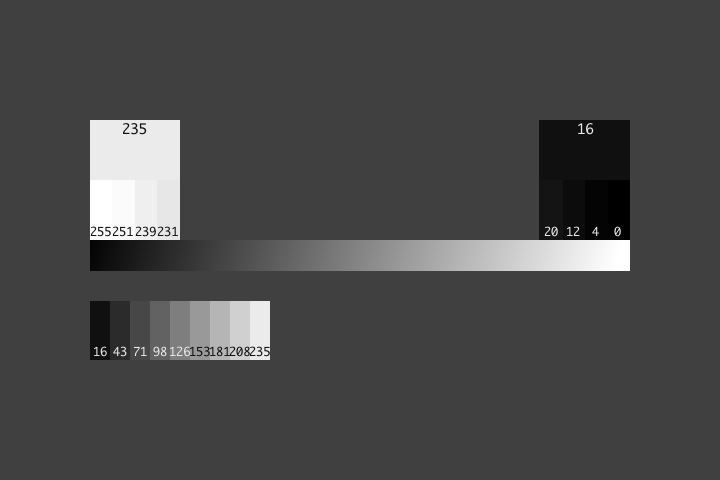

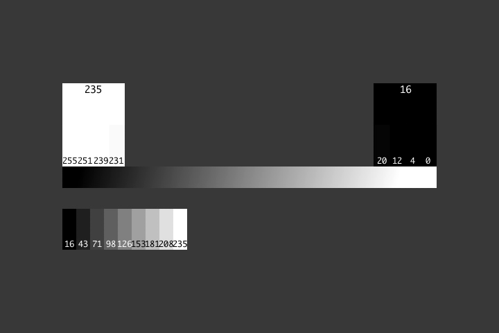

    Here's an MPEG elementary stream with the full luma range from 0 to 255:
    r0-255.m2v

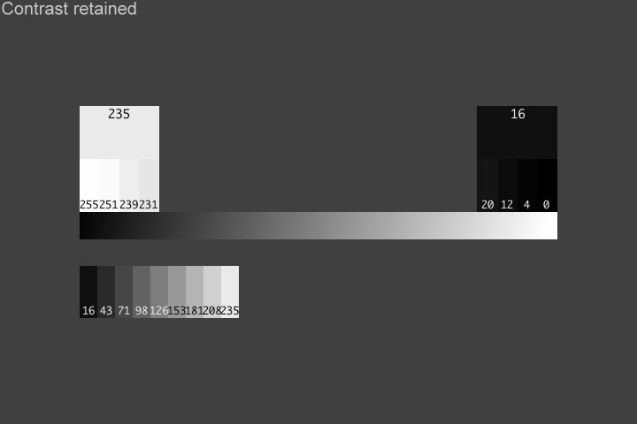

    On a properly calibrated player and TV you should not be able to see the difference between the areas marked 16, 12, 4, and 0 (they should all be black). You can often see a difference between the areas above 235 depending on the TV.
    If your software expands luma 16-235 to RGB 0-255 it will look like this:
    If your software doesn't expand the contrast it will look like this:

  6. Converting to animated gif loses a little precision but you can still see the difference:
    Notice how the whites above 235 become totally white and the dark grays all go completely black when the contrast is expanded. Note that normal YUV video should not have luma below 16 or above 235 so the contrast expansion isn't a problem when converting to RGB.

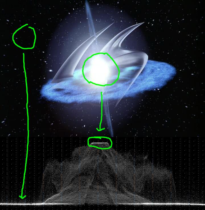

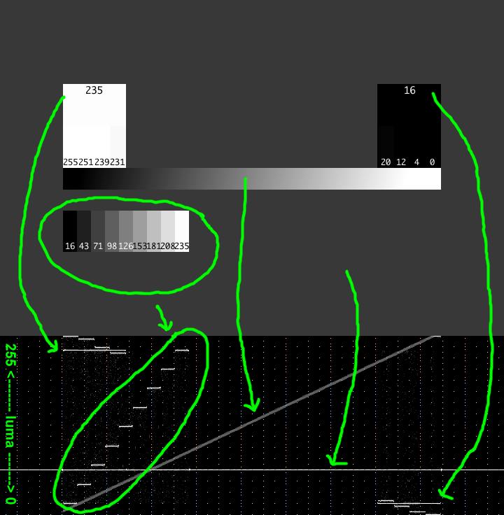

    If you know now to use AviSynth you can use the VideoScope() filter to display luma values while still in YUV space:
    I've added all the green arrows to show where different features of the video appear within the graph. For example, the smooth gray scale from black to white appears as the smooth diagonal line from bottom left to upper right. The 235 patch appears as a horizontal line. The 231 to 255 patches appear as shorter horizontal lines above and below the 235 patch. Keep in mind that normal video would not have those excursions above 235 (and below 16). Also note that I created this image using VirtualDub which performs the usual contrast expansion when converting YUV to RGB. So the RGB values are not the same as the source video's luma values and the bright and dark patches have been clamped.
    A DVD rip (Lost in Space trailer):

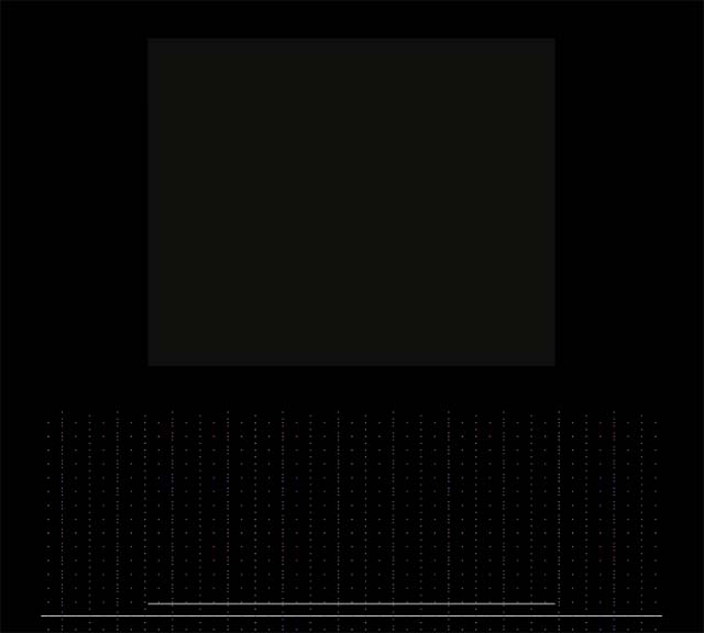

    Based on what I see on jagabo’s picture, the black background appears to be luma 16.
    The black slides appear to be luma 32 & the white slides luma 235. I’m guessing black level in the slide images is getting hit twice with an adjustment.

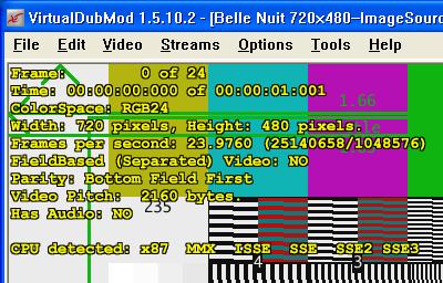

    Did you use AviSynth's ImageSource() to create the slideshow? That would have given you RGB data. ConvertToYUY2() would compress the RGB contrast (0-255) to the valid YUV range (16-235). If you want to avoid the contrast compression use ConvertToYUY2(matrix="PC.601"). Going the other way around use ConvertToRGB(matrix="PC.601") to retain contrast levels.
    You can use Info() in your script to tell you the current (as of the line you add the command) colorspace:
    ImageSource(...)
    Info()

    1) I added Info() to the end of the original .avs file and get ColorSpace: YV12.
    Black slide looks dark gray.
    2) If I change to ConvertToYUY2(), then it shows ColorSpace: YUY2.

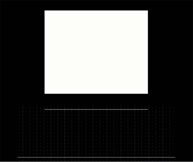

    The three working versions all display the black slide as dark gray, but only version #2 provides the VideoScope in order to quantify it.

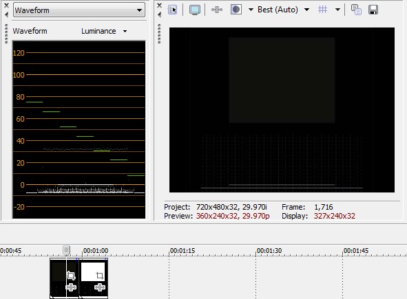

    First picture shows the black slide surrounded by the black background.
    Second picture shows the white slide surrounded by the black background.

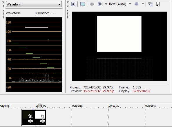

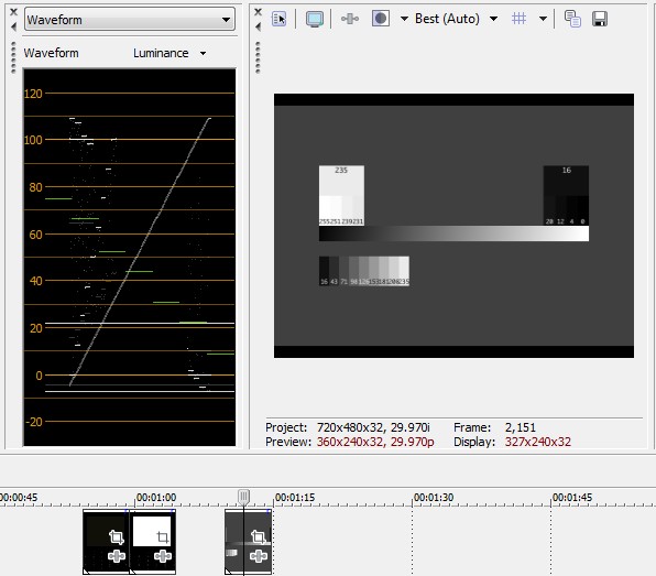

    Placing your charts on the DV timeline, Vegas shows center black at correct level 16 and border at sub-black digital zero.
    The white is showing at 255. Nominal white should be at 235 for DVD with transient excursions above.

  20. Originally Posted by edDV
    That's because his image was converted to RGB with the usual luma expansion before saving as a jpg image. The Videoscope graph shows that the outer black box is at luma ~16, the inner box at luma ~32. The same is true for the white patch, before luma expansion it was ~235.

  22. Member edDV's Avatar
    Mar 2004
    Northern California, USA
    Yes, the videoscope is showing the correct story per your vs.jpg chart.
    The vs chart above appears like this on a traditional waveform monitor.

  24. I haven't analyzed the entire script. There are a lot of Levels() and ConvertTo...() where the problem could be happening. But try changing the part that reads:
    Try {
    imgout=ImageSource("C:\Temp Video\black white black slide 9_temp_files\black white black slide 9%06d.ebmp", 0,3, rate)
    To:
    Try {
    imgout=ImageSource("C:\Temp Video\black white black slide 9_temp_files\black white black slide 9%06d.ebmp", 0,3, rate).converttoyv12(matrix="PC.601")
    Ie, add ".converttoyv12(matrix="PC.601")" to the end of the long line.
  25. Member
    Jan 2006
    I added ".converttoyv12(matrix="PC.601")". It made the black slide black, but it also made the white slide black.
    Also tried ".converttoYUY2(matrix="PC.601")", both slides were still black.
    Also tried ".converttoyv12" and ".converttoYUY2". Both of these looked like the original & displayed a dark gray slide.
  26. You mean the image with the white patch came out completely black?
  27. Member
    Jan 2006
    Yes, the white image was completely black. I cut/past the additional script to make sure there would be no mistake. I tried this a few times to make sure. I also changed the script on another .avs file of 18 slides and they all displayed black.
    As I looked at the following line, I noticed something.
    My slideshow .avs file is "C:\Temp Video\black white black slide 9.avs“.
    But the program created a folder for the temp files, “\black white black slide 9_temp_files”. There are 4 files, all with the extension of .ebmp and all are 507 KB in size. I’m guessing the background image plus the 3 slide images.
    I searched on “ebmp” and found this.
    http://avisynth.org/ImageSource
    I looked at temp files for other .avs slideshows & they follow the same format. If the program is loading images saved in the temp file, could their colors already be converted before saving?
    If I burn a DVD-R directly from the slideshow, no temp file is created, at least not one that I ever saw.
  28. Originally Posted by Mike99
    ImageWriter() produces .ebmp files with the colorspace of the source. If it's RGB you can rename the file .bmp and any paint program should be able to open it. YUY2 and YV12 are more difficult. It's possible the contrast has already been changed in the ebmp files. Try looking at one.
    I may download the slideshow program and take a look myself...
    <edit>
    I downloaded the program and found that the ebmp files are in YV12. The black level (Y) is set at 30, and the white level at 235. In the AVS script that I exported the very last line was "Levels(32, 1, 235, 16, 235, coring=false)". This restores the black to the approximately correct level, Y=16. I don't know why the program bumps the black level up only to bring it back down again later (losing a little precision in the process). In the end, the AVS script and an exported MPG file had correct black levels in the picture data.
    The background was handled differently though. During the script the black and white levels appear to be correct, 16-235. But that final Levels() command brings the black level down to 0, crushing blacks within the background image.
    I don't know why your script was missing the final Levels() command. Maybe there is an option somewhere within the program that controls this?
    </edit>

    When I added the “ConvertToYUY2()” and “VideoScope("bottom", true, "Y", "Y", "Y")” lines to the end of the new script, it looked like the black background was luma 16. I did not see it going down to 0. Is the “ConvertToYUY2()” changing it back up to 16? Or am I misinterpreting the something?

    I had several .avs files and none of them had the “Levels” last line. I was using program version 09.07. I wondered if something had changed, went to the program web site and there is version 09.08 dated today, Nov 11, 2008.
    I d/l the new version and guess what - a saved .avs file now has the “Levels” line. It appears that you got the new version right after it came out.
    You mentioned “The background was handled differently though. During the script the black and white levels appear to be correct, 16-235. But that final Levels() command brings the black level down to 0, crushing blacks within the background image.”
    If you just want a black background there is no problem. The problem is that blacks below RGB 16 in a background image all get crushed luma 16:
    (That image was converted from YV12 to RGB without the usual contrast expansion so black should be at 16, white at 235. But remember the numbers printed in the images are the intensities of the original RGB source.) Notice how you can differentiate the 0 and 16 patches in the the inner image, but the 0 and 16 patches in the background image are both same intensity. So dark details in the background image would be lost.
    I think the added Levels() command in the latest release was a quick and dirty fix for the main image and they didn't realize they were screwing up the background image.
