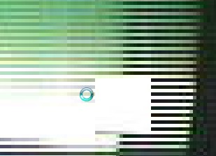

    Hope this works..
    This is from the latest capture I did when I tried to get the whole tape. Didn't get it, ran out of disk space on the drive. I haven't looked at it all, but the quality doesn't look very good. Maybe due to the lack of disk space?
    Any thoughts?
    Thanks,
    Al.
  17. Member edDV's Avatar
    Mar 2004
    Northern California, USA
    That looks like dirty heads or worn tape "dropouts". You should be able to see these on a direct feed from the camcorder to the TV. It might be possible these occur on the firewire transfer but much less likely.
    1. First try a cleaning tape.
    2. Try to play the tape in another camcorder to a TV to see if dropouts follow the tape.
    PS: The line splits are normal interlace. The player will deinterlacer will deal with the lines. You seem to be showing the VLC default to "Disable" = no-deinterlace.

  18. Member edDV's Avatar
    Mar 2004
    The blocks you are seeing are the 16x16 pixel macro blocks that can't be corrected by the camcorder's dropout compensator. Another camcorder might do better.
    You can see the dropout compensator working to the 8x8 block level in the greenish macro blocks above the white one.
    http://www.kiva.org/about
    Nov 2008
    You're right - for that capture, I was showing it with defaults, I need try with de-interlace set to Mean as you suggested, but it didn't make any difference. Unfortunately, the only way I have of seeing the output from the camcorder on the TV is through the video which is in the loft I can't see the blocks on the camcorder screen, but it is a small screen. I will see if I can get hold of something at the weekend to allow me to play back the camcorder directly to the scart on the TV, think I used to have some kind of adapter which took the 3 plugs from the camcorder lead and pugged into a SCART socket.
    I don't think its the tape, though, as I managed one capture of the sequence without any of the blockiness. I don't suppose that rules out the heads on the camcorder, though..

    Can you make a screen cap of the "blockiness" and post it here ? VLC will do it (under Video tab "Snapshot").
    It may be dirty heads or worn tape but that would show if you played from the camcorder directly to a TV
    Hope this works..
    Any thoughts?
