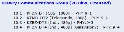

	Imagine the Master Control nightmare for your local CBS KFDA-DT that also simultaneously operate three other networks on the same digital channel. This is in addition to running the analog transmitter feeds.
 The CBS HD must be fairly low bit rate since they carry three other SD stations on the same digital channel.Recommends: Kiva.org - Loans that change lives.
