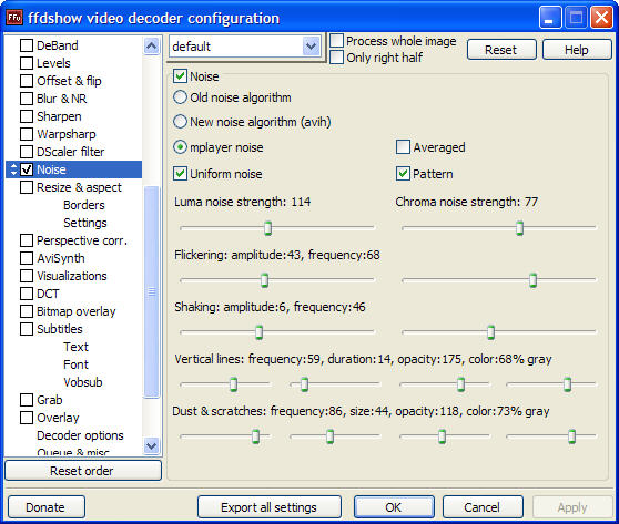

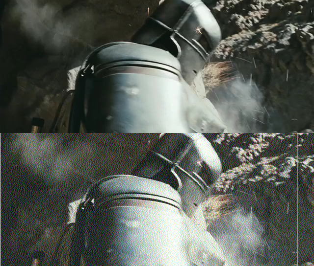

You can easily generate your own noisy clips quite easily by using ffdshow's noise filter. You can adjust the type of noise & frequence of flickering, shaking, lines, chroma/luma noise, etc...
Just set ffdshow show as the decoder for your source material, and encode to whatever output format you want your clip in. Don't forget to "reset" the noise filter when you're done, or all your directshow encodes and playback will have this "noise" !
