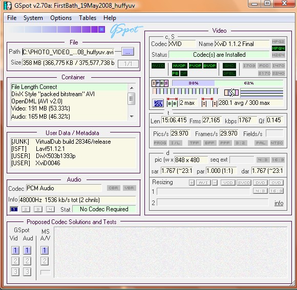

I am using a script downloaded earlier from this forum to create a 'huffy' AVI file (the end result is quite a big file, as anticipated). Now, I want to encode it to 'xvid' using Virtual Dub. However, VDub is complaining about non-suitable codecs when I try to load the 'huffy' AVI file, asking for some Video for Windows codecs. What can be done?
On the same note, when I deploy '_multi_demux_mts_Xvid.bat' (a script posted earlier by soopafresh) directly on a MTS file, the resulting xvid AVI cannot be played back on some older DVD players that are DivX/XviD enabled. I suspect the newer/newest codecs are being used and some devices don't have the necessary updates. Hence the question - is the script calling the current xvid encoder installed on the system or does it use the 'ffmpeg.exe' which came along with the script itself and lives in the same directory? Simply put - what can I do to control which xvid encoder version I want to use when running the aforementioned xvid script ?

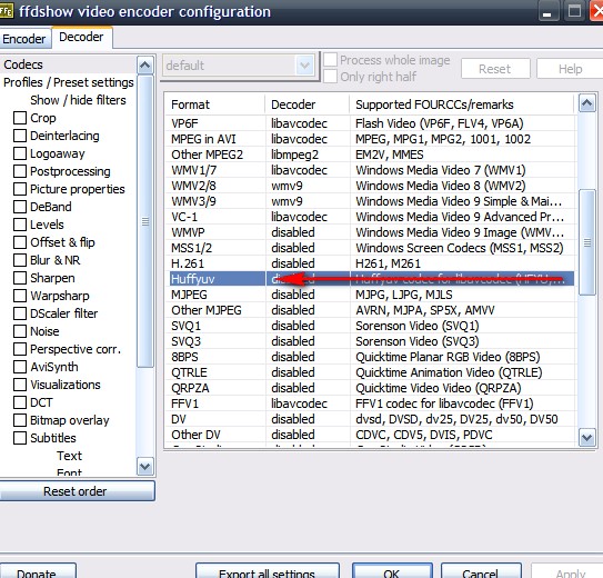

Darn. Well, as jagabo suggested, install Huffyuv and Xvid and do the conversion with Virtualdub
You can turn on Huffy in 2 places
Also, does your DVD player accept files which are 720x400 in dimension? I seem to recall 640x352 was the max on some older players. -
soopafresh - yes, that's the spot and huffyuv is enabled. What I seem to have screwed up is the very compression codec in VDub (duh!). I was not using ffdshow's
xvid. Anyways, I'm running it now again and it seems a lot faster than processed previously. 'Will post some results soon.

848x480 is too big. You have to use 720x480 or less for NTSC sources. I recommend 720x368 for widescreen, 640x480 for 4:3 material.

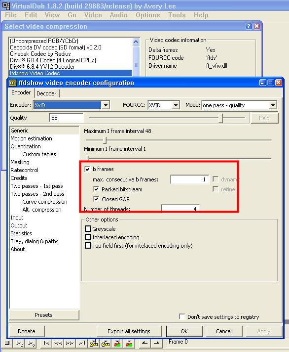

A 3 year old Philips Divx/DVD Player? The DVP-642? Players from that generation have more restrictions than the newer Philips models. For safety you should set the Max Consecutive BVOPs to 1 instead of 2.
Yes, that's the one. Where do I set these BVOPs?

I recommend you select Closed GOP and Packed Bitstream there too.

jagabo - now it works correctly with both, audio and video. Except I used the DIVX codec. My Phillips DVP-642 doesn't like the XviD 1.1.2 codec for some reason. Many thanks for your guidance.
