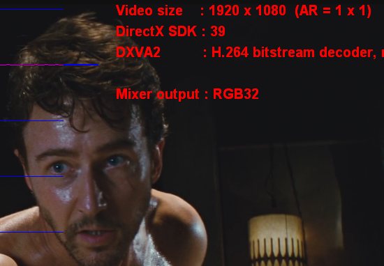

I picked up one of these yesterday. This post concerns playback of HD x264 MKV files on the WD player.
I tracked down the problematic 1080p MKV Terminator sample file referred to earlier in poisondeathray's quote from engadget, and also referred to by Inspex (the file was posted to Usenet on July 25th if you want to find it). It was not DXVA compliant (not that it was claimed to be); at least not with MPCHC (checked using CTRL-J). Summary video specs from MediaInfo: 10.2 Mbps, 1920*1040(16/9), at 23.976 fps, AVC (High@L5.1) (CABAC/8 Ref Frames).
It played fine in MPCHC using ffdshow decoding, but broke up into severe blocks and smears when played back on the WD TV, only clearing up when there was virtually no movement in the scene.
The only other 1080p clip I had handy was an Apple trailer (.mov) and it played fine on the WD.
Tried a couple of lower resolution x264 MKV files, 1280x720p and 1280x544p (made from BD source) on the WD player, no problems. Both were larger than 4GB and played back fine from an NTFS-formatted 8GB thumb drive. On the computer, I got DXVA playback with these in MPCHC. One was L3.1, the other was L5.1.
I downloaded 19 more 1080p/x264 MKV sample files to see if I could find what separates the good files from the bad. Of the 20 files, 13 played fine on the WD TV player, the other 7 were like the Terminator clip. When played on my computer using MPCHC, the 13 good files were able to use DXVA, the bad 7 were not. They all played fine in MPCHC, it's just that those 7 used software playback rather than DXVA.
All the good files respected ExDeus's formula: Height * Width * num_ref_frames <= 8294400. All the bad ones exceeded it.
http://www.avsforum.com/avs-vb/showthread.php?p=12691751#post12691751
So at 1980x1080 you could use up to 4 ref frames.
Most of the samples were cropped, so that the height was less than 1080, which allowed for more ref frames. Several of the cropped files used 5 ref frames with no problems, and two of these used L5.1, which also caused no problems.
All the troublesome files were uncropped (black bars above and below) and used more than 4 ref frames.
Two of the files I downloaded were from the same release group (hV) that did the Terminator clip. They were uncropped, but only used 3 ref frames compared to the 8 used in the Terminator, so they played back fine.
In summary, it looks like the WD player's criteria for playing back HD AVC are very similar to those for DXVA playback on a PC, for whatever reason.
So, if you're encoding files to playback on this device, follow ExDeus's formula and you should be alright. He's got more guidelines in his main article here, along with tips on how to possibly fix, without re-encoding, some 720p files that you may have problems with:

According to the ExDeus post I linked to above, MPCHC's decoder will allow DXVA for files using a tag of a L5.1 as long as the other conditions are met, while the Cyberlink decoder will not allow higher than 4.1. The WD acts like MPCHC in this regard; I don't know about the PS3.
Audio was fine, but I'm just using stereo.
I did a quick check on DXVA in MPCHC and they both passed.(When it can't use DXVA, MPCHC says "DXVA: DXVA not used". If it can use DXVA, it looks like this shot from your m2ts):
