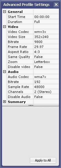

 I've attached a jpeg of the encoder settings.

 Your encoder was set for 4000 kbps but the nominal rate reported by MediaInfo was 9802. MediaInfo is probably just showing the max bitrate in the MPEG header. But if you have peaks at that rate (or near it) with two audio tracks, 448 kbps, and 192 kbps, you will be exceeding the total bitrate allowable for DVD -- around 10050. When using VBR encoding set the max bitrate to 8000 to 9000.

	I really can't understand what's going on here. You'll just have to look at the video to see what I mean. The beginning of the movie is great. Excellent "smooth" playback. Take a look at the movie though particularly after 2:50 to 3:35. Notice as the priests move around how the movie "plays, pauses" while the audio is perfectly in sync. I hae determined that the fps is NOT the issue. I have come to this conclusion by adjusting the fps to 18. When I played it back the choppiness showed through. The reason I used this method was because you could tell that the choppiness was still present and still moved the frames out of sync even when the fps was adjusted. The file is approximately 50 megs. However, I have uploaded the encoded sample to a high bandwidth server. Take a look. Here's the encoder settings. Sample: http://stablefiles.net/files/extra/Title_03.wmv
