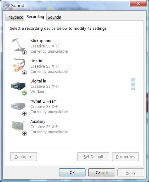

Assuming this is a windows pc go to the control panel and select sound. Then go to the recording tab and make sure there is a selection available for a microphone. Than hook up your mic and try using it. Leave the control panel sound window up and it should have a little green volume indicator next to the mic icon while you speak into it. That should indicate that the microphone is working correctly.

EDIT - I see in your computer profile you are using VISTA. There is a shortcut I was unaware of. You don't need to go to control panel to test this. Just right click your volume speaker icon on the task bar and select recording devices. That will take you directly to the recording tab I was speaking of earlier. Than you can test your microphone some more. - Oh and just double check that you are plugged into the mic jack instead of the line in jack. I know its obvious but sometimes we can be forgetful - never hurts to double check
