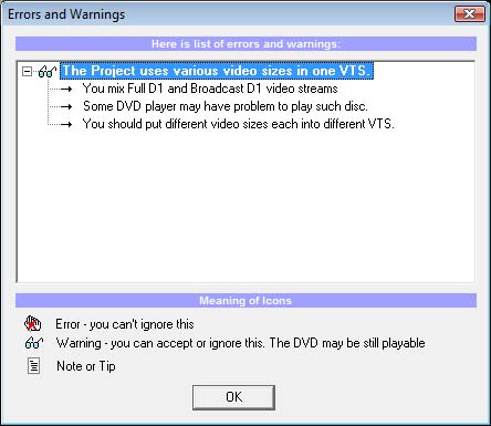

First, that is only a warning and can be ignored if you want. If you were trying to mix 4:3 and 16:9 or PAL and NTSC in the same VTS I would say split them up, but mixing Full and Broadcast D1 is not so much of an issue.

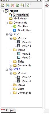

Sceond, adding a new VTS is as simple as Right-Clicking on the project tree and selecting Add New VTS.Read my blog here.

It's just like the main VTS that you already have. It has movies, menus etc. Put all your Full-D1 in one VTS, and the Broadcast material in the second VTS.

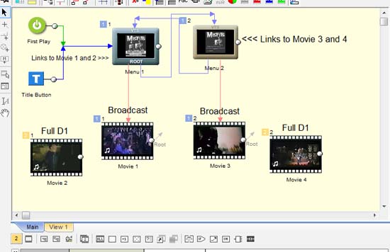

This is how it looks right now. I can't make it work like this. Could you please show me how to do it?
Thanks!
I think you need to use the BRIDGE command. A bridge is the icon at the bottom of the screenshot you posted 6th from the right.

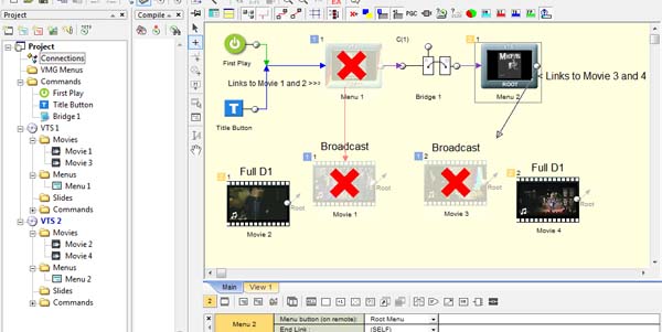

Used a bridge, can't draw connections to VTS1.
"create an over-riding menu at the VMG (top) level that can call either menu."
Wouldn't know how to......
If you want to stay with what you have, than use a bridge for menu1 button for movie2 and second bridge from end of movie2 to menu1. Same thing for second menu and movie4.
Otherwise do what guns1inger suggest, VMG menu, which will direct buttons to all movies.
This is for your first picture.
Unless you want to play movie 1 and 2 after each other, than use bridge from end of movie1 to start of movie2 and second bridge from end of movie2 to menu. Same for other two movies.
