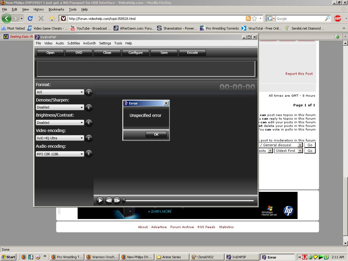

Use Xvid4PSP to convert your files to Xvid. Open the file, then click on Video -> Resolution/Aspect Ratio. Toward the bottom is Black Width / Height, which is where you can add borders. Set the size you want in pixels, click Apply, then OK, then use the AVI Hardware settings to create a hardware playback compliant Xvid.
Read my blog here.
It says I need .NET Framework 4.0?? Where do I get it??
I am using SP2 still because a lot of issues have happened in the past when I got SP3 My Nvidia Drivers got messed up. -
I'd be surprised fi SP3 caused that. if you have been running all the other updates to Sp2 then SP3 does very little. Anyways, there is no .net 4. Xvid4PSP needs .net 3.0, and there is a link on it's home page here : http://www.winnydows.com/page.php?2
Read my blog here.
Whenever I try to open up a Anime AVI that is H364 I get a Unspecified Error.

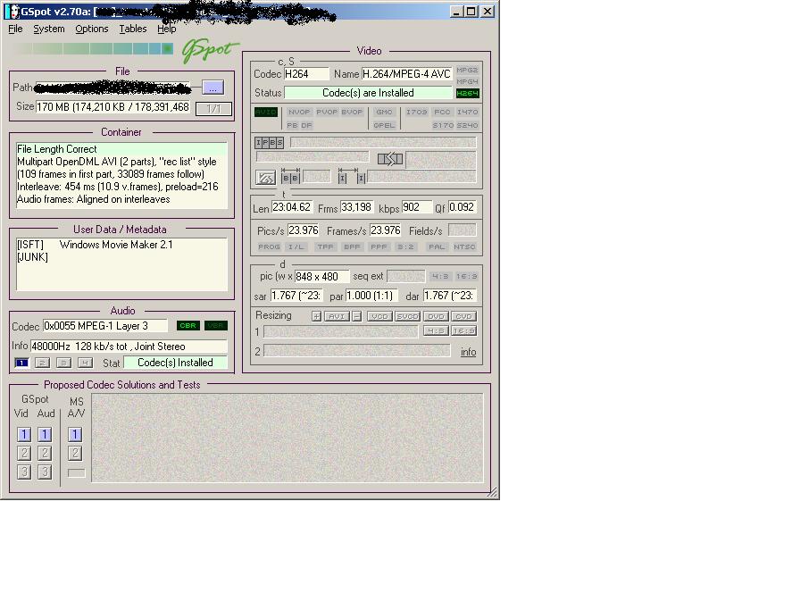

Sorry, I forgot you had already posted a GSpot screenshot indicating an AVI with Open DML extensions. It sounds like you have already verified that h.264 is enabled for both VFW and DirectShow. But here are the two settings to check:
Start -> All Programs -> ffdshow -> VFW Configuration -> Decoder tab -> Codecs in the left pane -> H.264/AVC in the right pane -> libavcodec
Start -> All Programs -> ffdshow -> Video Decoder Configuration -> Codecs in the left pane -> H.264/AVC in the right pane -> libavcodec -

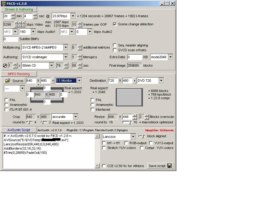

I would use VirtualDub or AviSynth plus VirtualDub. You can use FitCD to determine the border size. -
I have VirtualDub...VirtualDubMod..AviSynth...n FitCD...So how should I add the borders and Also what Frame Size should I make the videos 640 x 480 or 720 x 480 or 704 x ??
When I took the AVI and made it a Script in FitCD with 2 Blocks setup...I imported it into VirtualDub...and Tried to make another AVI but it is like 20GB's..
I have AVI Synth but I have never used it because it seems really confusing I have worked with Virtual Dub on the level of editing videos length.
So any easy to follow guides on AVISynth and VirtualDub. I have AVISynth 2.5 -

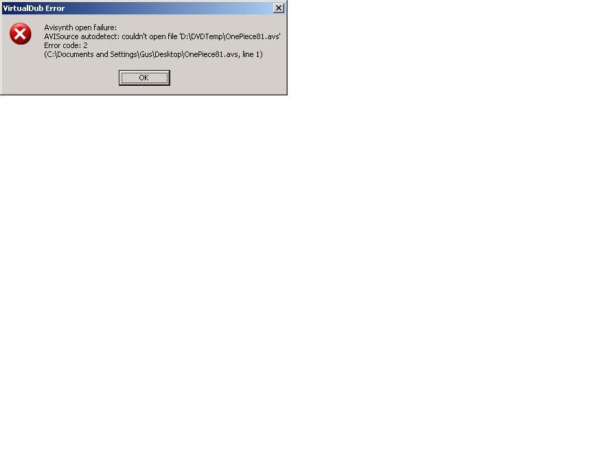

You probably don't need FitCD. Create a simple avisynth script
AVISource("path to your file\filename.avi")
Load this into virtualdub and test that it opens correctly.
Apply the resize filter, but don't resize the image (you don't need to or want to), but use the filter to add the borders that you need. From here you can re-encode.Read my blog here.
So do I have to make a Script for each video I want to change and after I make the Script how do I add Black bars with 2 blocks like FitCD Does??
Whats next? I like how FitCD you just set it up once and it is done...Is there any way to make this easier??

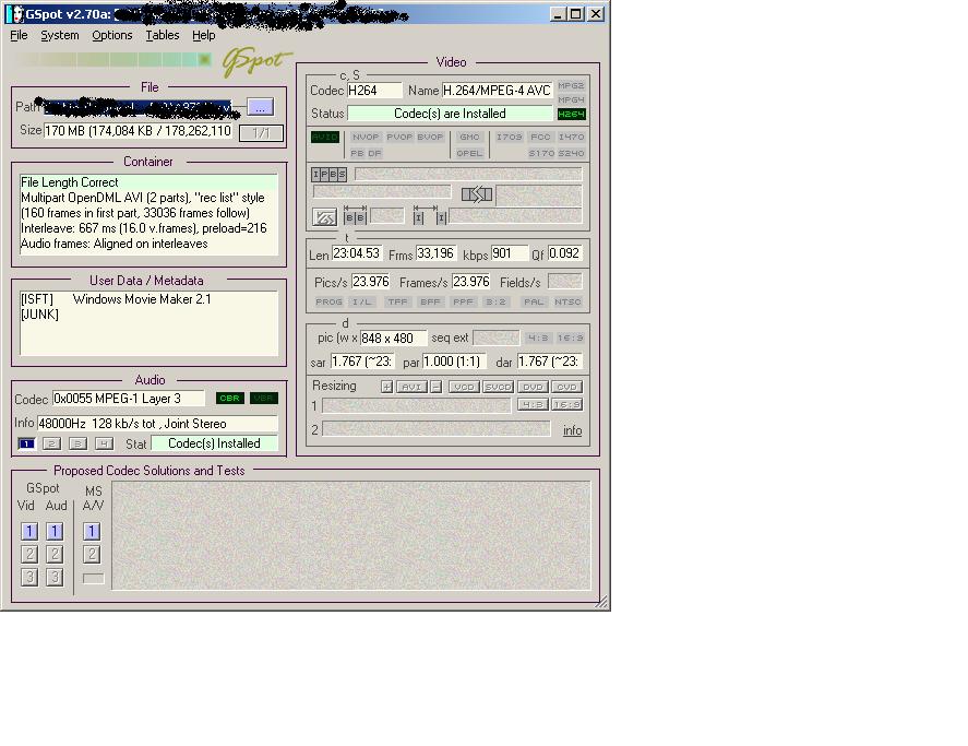

I checked the File Info in VirtualDUb and here is the settings. I wanted to say thank you for all your help everyone so far especially gunsl1nger..I appreciate it. I figure things out slowly but surely. Avs Script is very new to me so please be patient. Thanks again
