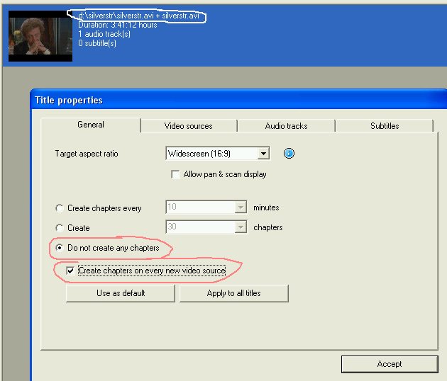

  6. It seems like with DVD Flick (my version is 1221), you can click Add Title (just one time for your whole project) and input your first clip, and then for adding subsequent clips, click Edit Title> Video Sources>Add >browse for clip>Accept. Do this last part repeatedly to input all your clips. You should see all your clips entered on the top, each clip separated by + sign (see white circle in screenshot). In this case I have 2 clips total. (But I think the total duration of all your added clips should be not much more then 2 hours.) Then on Edit Title> General you can click Create chapters on every new video source
    and also you can click Do not create any chapters>Accept.
