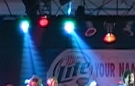

DV is interlaced and if you're not using software that deinterlaces it's going to look like shit on a computer especially during fast motion. Here's a cropped shot of a single frame. Note that interlaced material should not be deinterlaced when encoding.It captures at 720x480 but it looks bad with lots of choppy vertical edges
Software deinterlace will near always be inferior to motion adaptive hardware deinterlacers found in better HDTV sets. For this reason, I'd recommend capturing, editing and encoding to 720x480i and let the TV deinterlace it.Originally Posted by thecoalman
If viewing on a computer, use a deinterlacing player.Recommends: Kiva.org - Loans that change lives.
