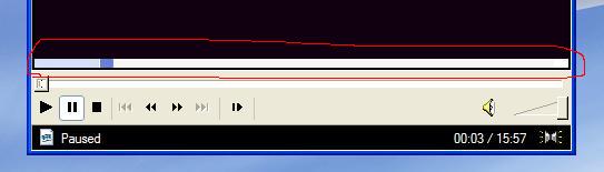

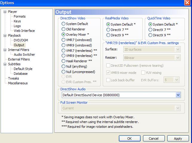

    I'm using MPC/Media Player Classic and if Overlay Mixer* is selected under Output (see attached) then some of the vid clips would have the bottom border NOT filled to the player (2nd pix), how come?
    What is the best Output to use?
    System Default
    Old Renderer
    Overlay Mixer*
    VMR7 (Windowed)
    Null (uncompressed)

    2nd pix, look at the border/bottom of the player.
  3. What are the specifications of your video? e.g. non mod16 dimensions? some .mpg have "rough borders" which is not visibile on their intended target (overscan on TV's)

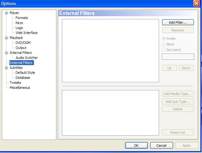

    No external filtere under option - external filters, see attached pix.
    I only have the border problem when Overlay Mixer* is selected, all other (System default/VWR7/VWR9/Haali...) are all fine, except :
    1) Overlay Mixer* = Best colours (but got border problem)
    2) System Default or VMR7 (Windowed) = almost identical to Overlay Mixer* (no border problem)
    3) VMR 9 (Windowed)/VMR 7 (renderless)/VMR 9 (renderless)/Haali renderer = colours too dark (no border problem)
    Is Overlay Mixer* the best one to select? or what most of you are using?

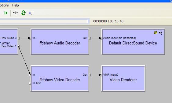

    From graphstudio!

    Thanks again poisondeathray , I think I solved my problem now , I enabled WMV1/7, WMV2/8 and WMV3/9 under ffdshow video decoder/audio decoder and I'm NOT seeing the border problem anymore . I 'm guessing ffdshow is now being used for all .wmv files as I can see the ffdshow tray icons while palying .wmv files.
    Best regards.
    P/s does anyone know why on the 1st GraphStudio both WMAudio decoder DMO and WMVideo decoder DMO are both showing GREEN vs the 2nd GraphStudio both are showing purple while using ffdshow?
