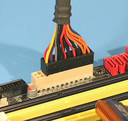

    BTW, I went ahead and picked up a slightly more powerful power supply this afternoon (300 > 350)... but the main connector on the newer power supply didn't match - the original is longer, and has 24 pins as opposed to the new one's 20. Just curious - even if it doesn't turn out to be the power supply, what should I look for to make sure I'm getting the right main connector? I don't know if it's listed on the box...

    Just buy a ATX 20 pin Female to 24 pin Male Adapter for that 300- 350 watt power supply you bought. The cost is cheap at $2.99 at SVC.com

    If you can't find a adapter, the 20 pin will still work with a 24 pin socket. As long as you orient pin 1 correctly. The extra four pins aren't generally needed unless you have a PCI video card that draws extra power through the motherboard. They are hooked to the same wires as the 20pin. They just supply the same current/voltage that's spread among more connectors. Early PCI cards stressed the 20 pin connectors and caused overheating at times, so they added more connectors.
    This page has a good explanation of how the PS connectors work: http://www.playtool.com/pages/psuconnectors/connectors.html Look down the page a bit to see what a 20 pin looks like plugged into a 24pin ATX connector:
