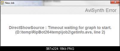

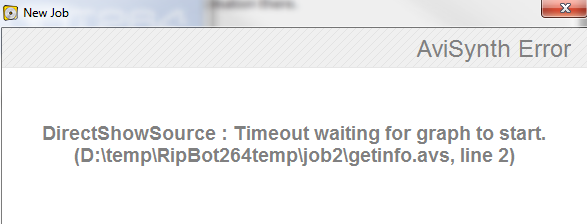

    I also get this error on my Win7 x64 in some VC-1 source files:
    Is there a solution??

    I use Windows 7 x64
