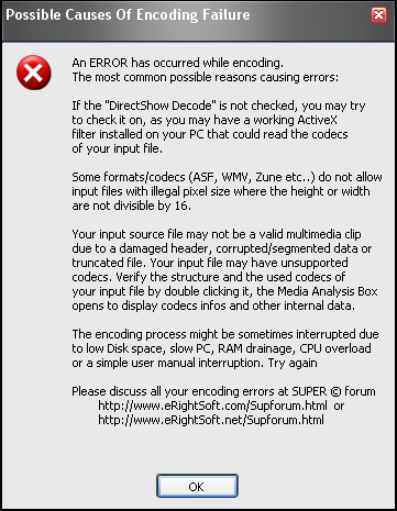

A friend ran the SUPER program. I'll worry about Xvid4PSP later when I'm awake.
