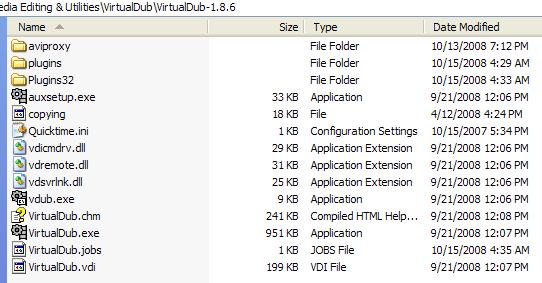

    Here are my Virtualdub main program folder as well as the Plugins32 folder, I CAN view/play .mov clips but not .wmv and .flv clips . (I'm getting missing codec with .wmv, unsupported with .flv)
    I read Baldrick's guide using avisynth and virtualdub, https://www.videohelp.com/forum/viewtopic.php?t=284288 , installed wmv9VCMsetup.exe, but still no go.
